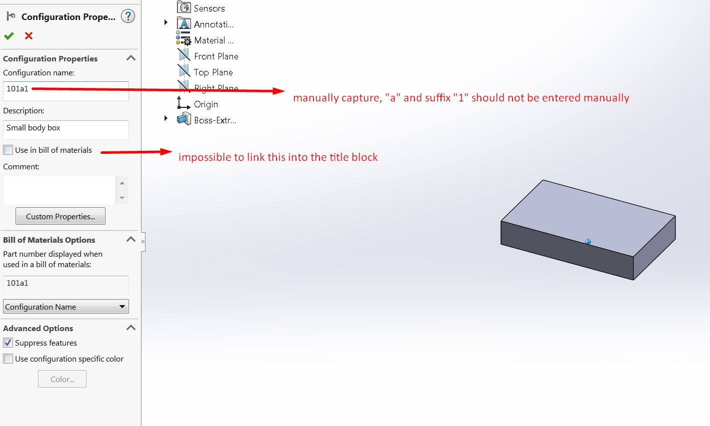

But because the size are done inside the same drawing part, by using configuration, I will face two problems:
1- I am unable to link the description of such configuration to the title block drawing.
I can pop it up inside a BOM by activating "use in bill of material", but it doesn't make sens to insert a BOM table into a single part drawing.

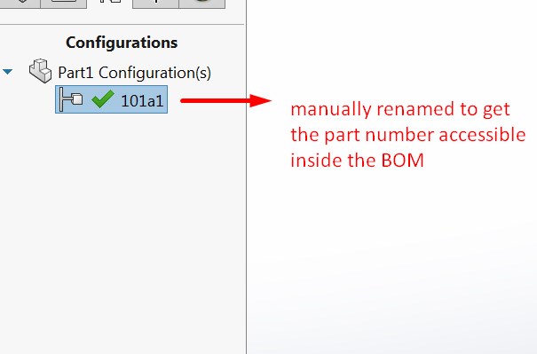

2- The part number, while in configuration property, is read from the configuration manager, by renaming the value inside the configuration manager. That means that the extra information link to the part number like the major revision "a" and the version "1" inside the part number must be done manually.
This doesn't sounds right and will end up with error for sure.

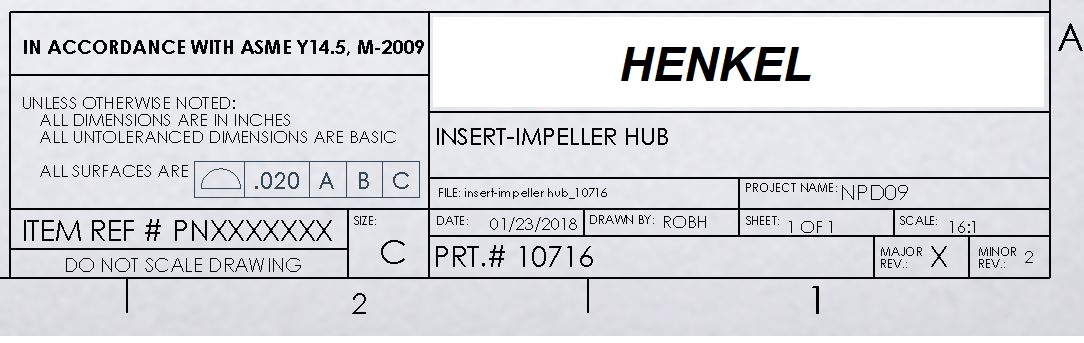

Thanks Robert, I tried several time to get something close to your system, but I may not get the logic behind the mechanism or I'm too short on solidworks, anyway, I can't get it 100% working.
What's exactly the meaning of : "These additional custom properties can be coded into title block and other notes so they read how you want them to".
What kind of code are you referencing too?
In my title block, there's 3 separate cells, part#, Major rev, and Minor rev, but often in notes I code the note so it includes part# and major rev together.
How did you do that?

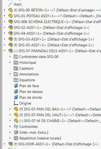

I name the big assembly with the suffix "00". Other assemblies with a suffix by order: "01,02,03 etc ...
The pieces may have a name that begins with the name of the assembly in which they are used followed by a description of the part. This requires planning the denomination before modeling. I have never regretted this procedure!
In other words: knowing where we are going makes the path much easier!

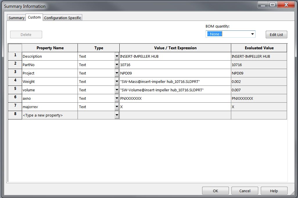

1. Using 'configuration specific' properties within the main part should take care of this issue for you. The configuration specific property will override the main property, thus you don't have to always create duplicate properties in multiple configurations, just the ones that differ.

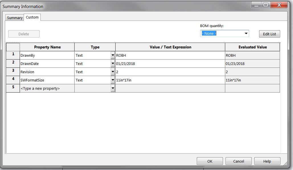

2. I use some additional custom properties in the part for the major revision (mine is called 'majorrev') and one called 'axno' for the MRP number, which changes if the major rev changes, but not the minor. I should have called it 'mrpno' because they're switching to SAP. Live and learn.

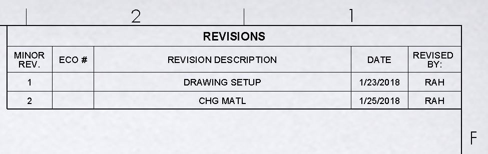

The 'minor rev' cell in the title block is driven by the drawings system property 'revision', which increments automatically if you're using the Solidworks Revision table. Right click>add revision If it goes 'a,b,c,' instead of '1,2,3' you can change that in options>document properties>tables>revision
These additional custom properties can be coded into title block and other notes so they read how you want them to.
This works great for balloons or arrow notes that point to parts to call them out, such as in an exploded assembly drawing.
Does that get you all set?
edit: included screenshots of all the usual properties and driven stuff.

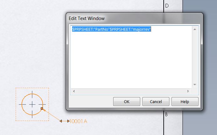

Coding was a bad word, Solidworks calls it "linking"
Linking custom properties into the title block cells and other notes is how one "automates" drawing information so that there is less chance for error.
Any text on the drawing that wants to match a custom property either must be edited by hand when the property updates (such as when something goes from rev A to rev B) OR, it takes care of itself because it's "linked".
Doing so isn't a requirement of the BOM system I laid out above but it is extremely nice to have, again, to prevent human typographical errors when properties update.
If you search your Solidworks help for "link to property", it spells it out pretty good.
You tell Solidworks the "secret code" and it knows to replace that secret code with the associated custom property.
The codes look like:
$PRP:
$PRPSHEET:
$PRPMODEL:
etc...
which tells the system where the property is linking from.
In my example, say I want to call out a component on an exploded print by it's current part number and major revision, I wouldn't just type in the part number and revision into the callout, I would type:
$PRPSHEET:"PartNo"$PRPSHEET:"majorrev"
and the note would appear as
10001A, as shown in the attached image.
The reason is, someday when the part changes to major revision "B", I only have to change the custom property in one place (the custom properties of the specific part) and it automatically updates in all title blocks, notes, arrow callouts, etc...
That's what the "coding" I mentioned was all about. Again, not a must-have, but a nice-to-have.
