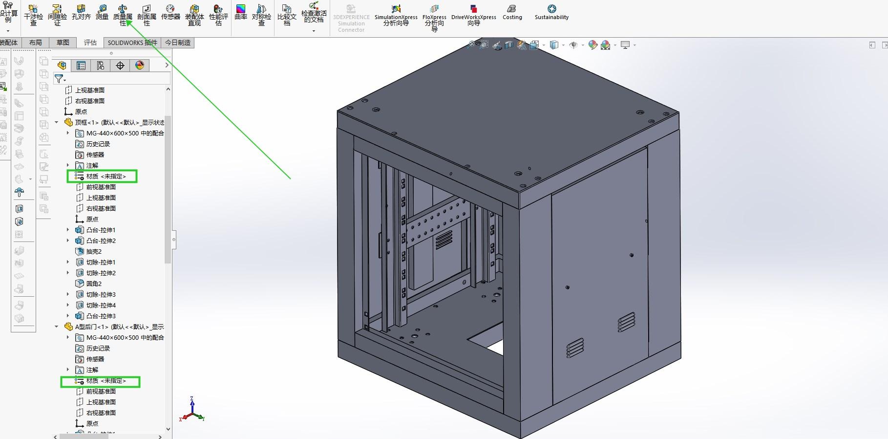

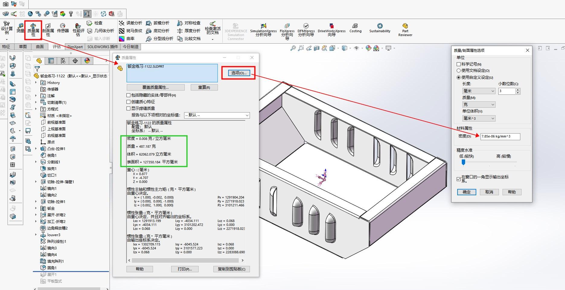

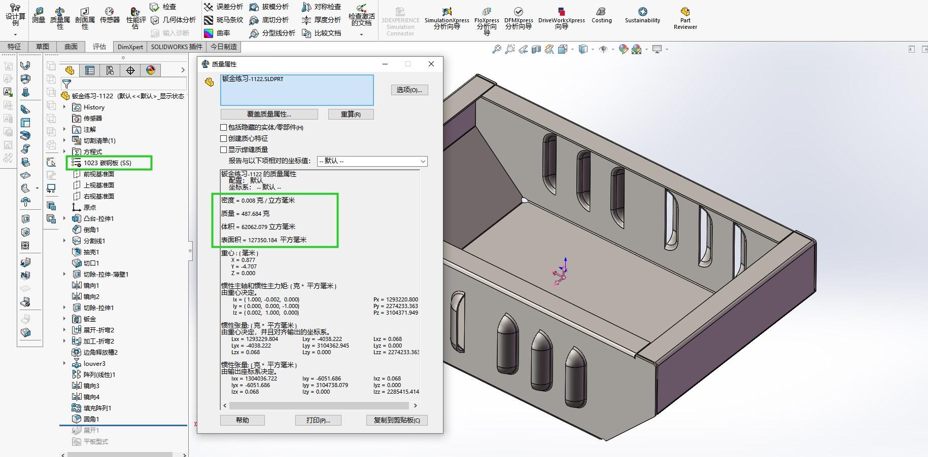

You can use the evaluation function of the software directly, and the specific steps can be seen in the attached drawing. In this process, you can specify the appropriate material for the sheet metal part in advance, or modify the density in the measurement results to obtain the weight of the part at the specified material or density. In the case of assembly, it is necessary to specify the material of all parts in advance and then click on the mass properties button (the default material density is 1 g/cm³).
