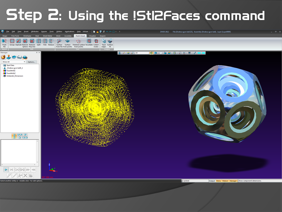

How to convert STL data into a surface model in ZW3D with one command?
In ZW3D is possible to do this by typing !CdStl2Faces in the command line and selecting the point cloud data! The whole procedure follows below:
2 Answers
The procedure in detail:
