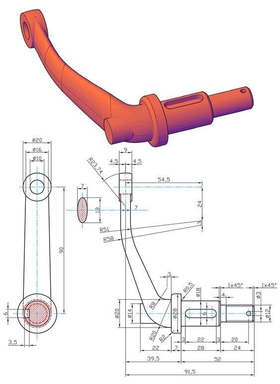

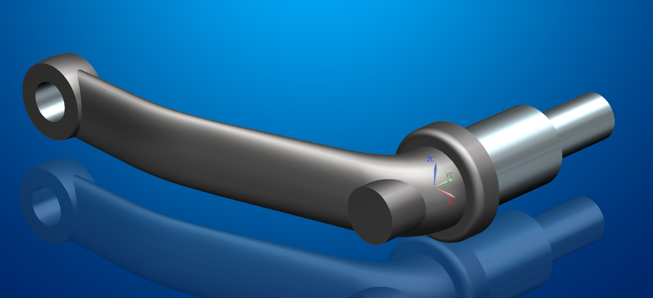

I having problem in designing the handle of the displayed drawing
Can any body help me in designing the handle of the displayed drawing

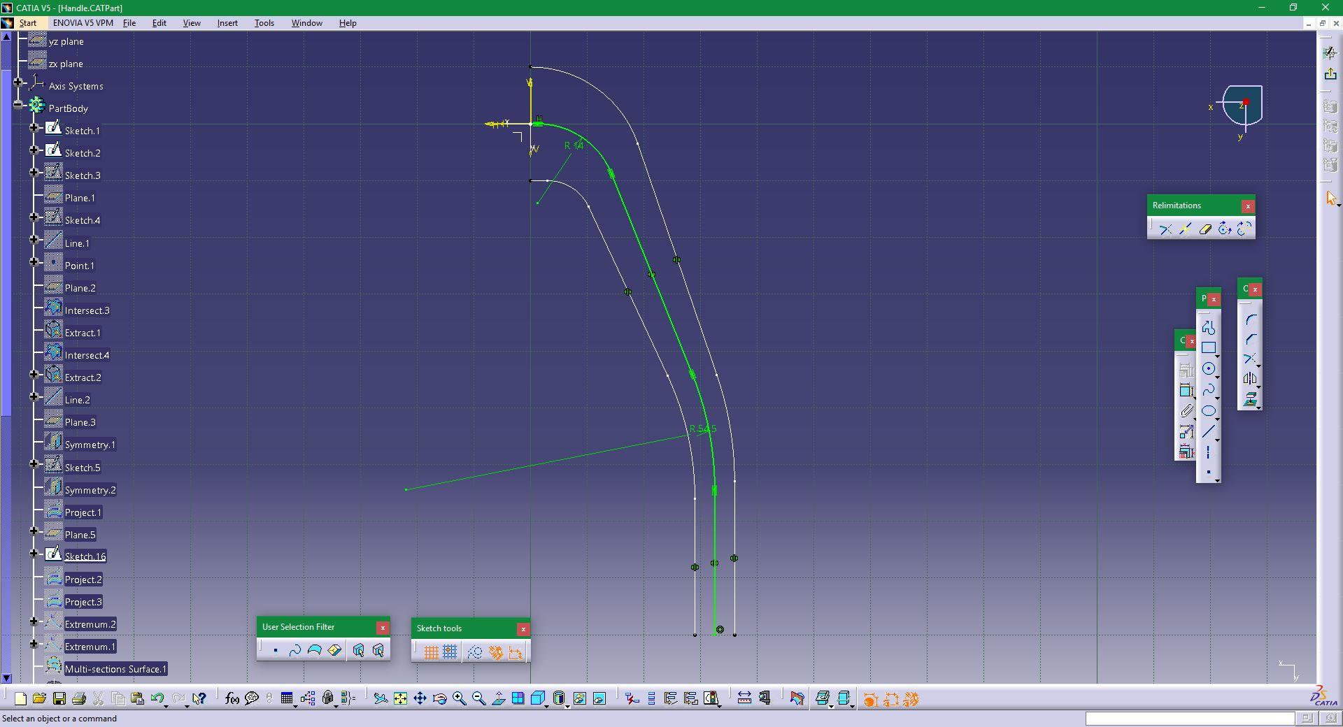

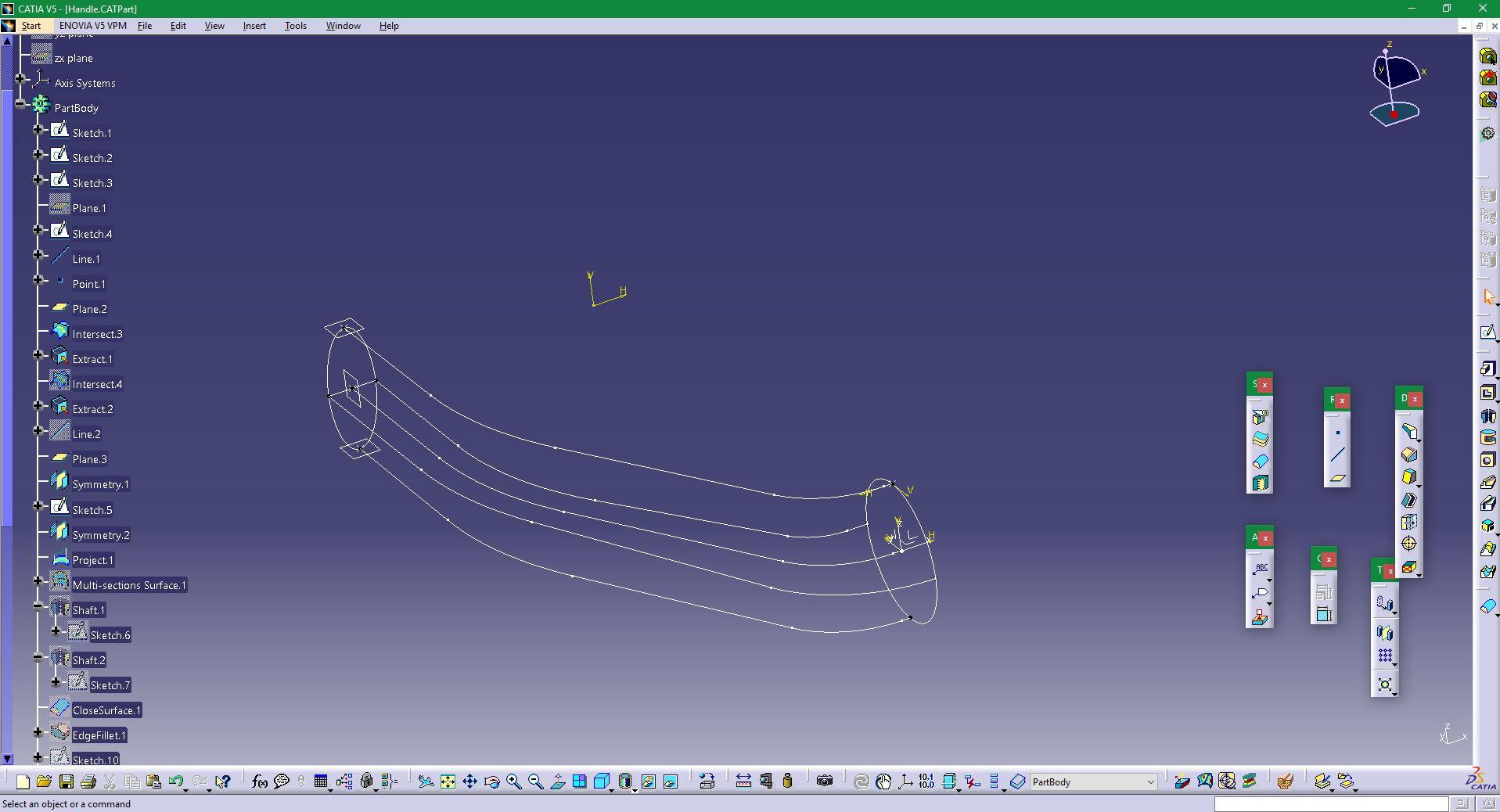

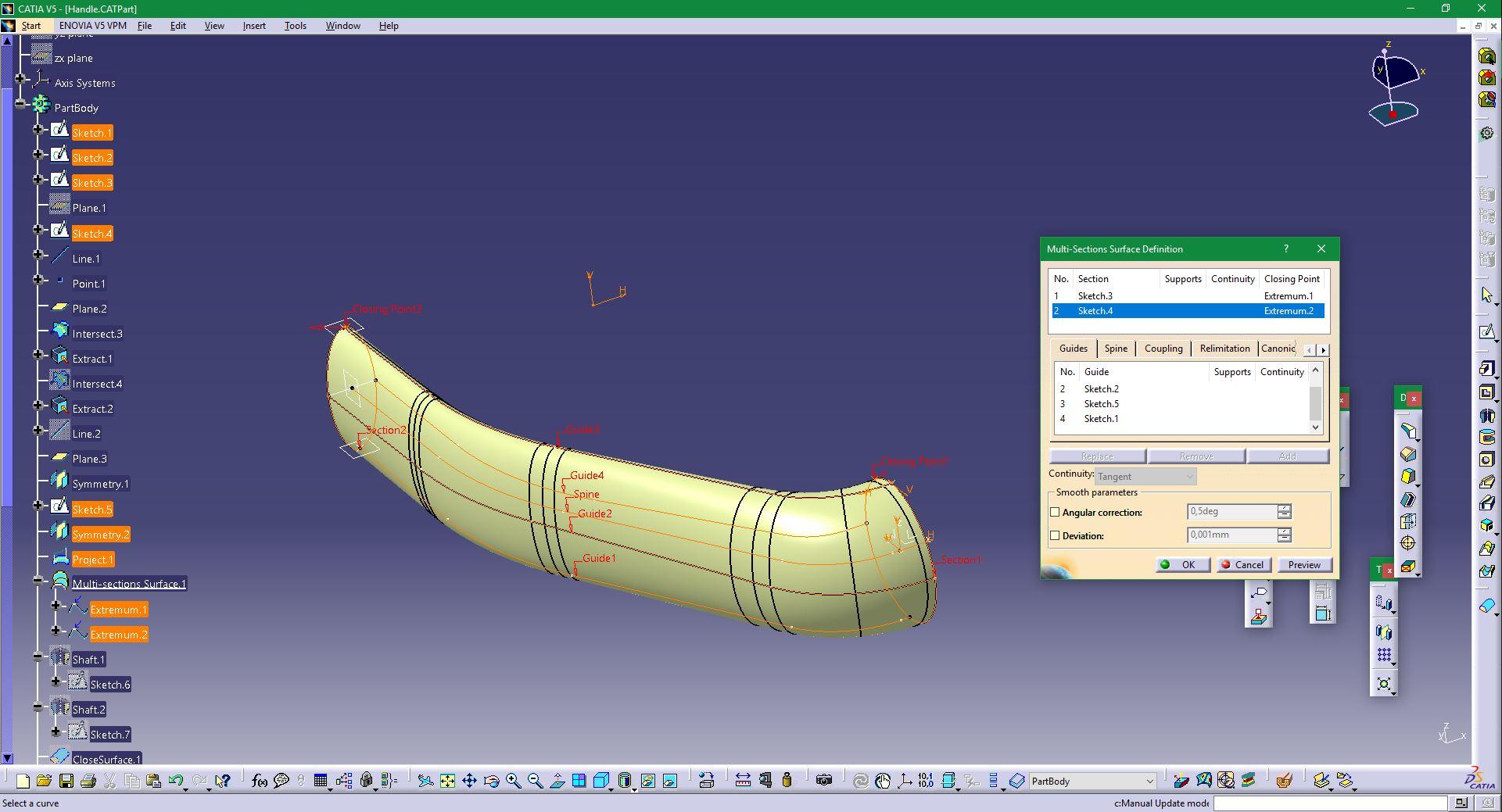

Here is my approach in CATIA. Note only the catpart have the tree functions saved.
in Catia i did the folowing:
Created the end sections
Created the side curves to act as guides
Created a plane to pass on top of the circle and on the top apex of the oval.
Created a mid curve as a spine
Projected this mid curve onto the angled top plane
This gives me 4 guides, 1 spine, 2 sections to follow.
Sorry, I don't know PTC Creo and don't have Creo to try this out.. but maybe the concept functions are the same in Creo you can use as in Catia.

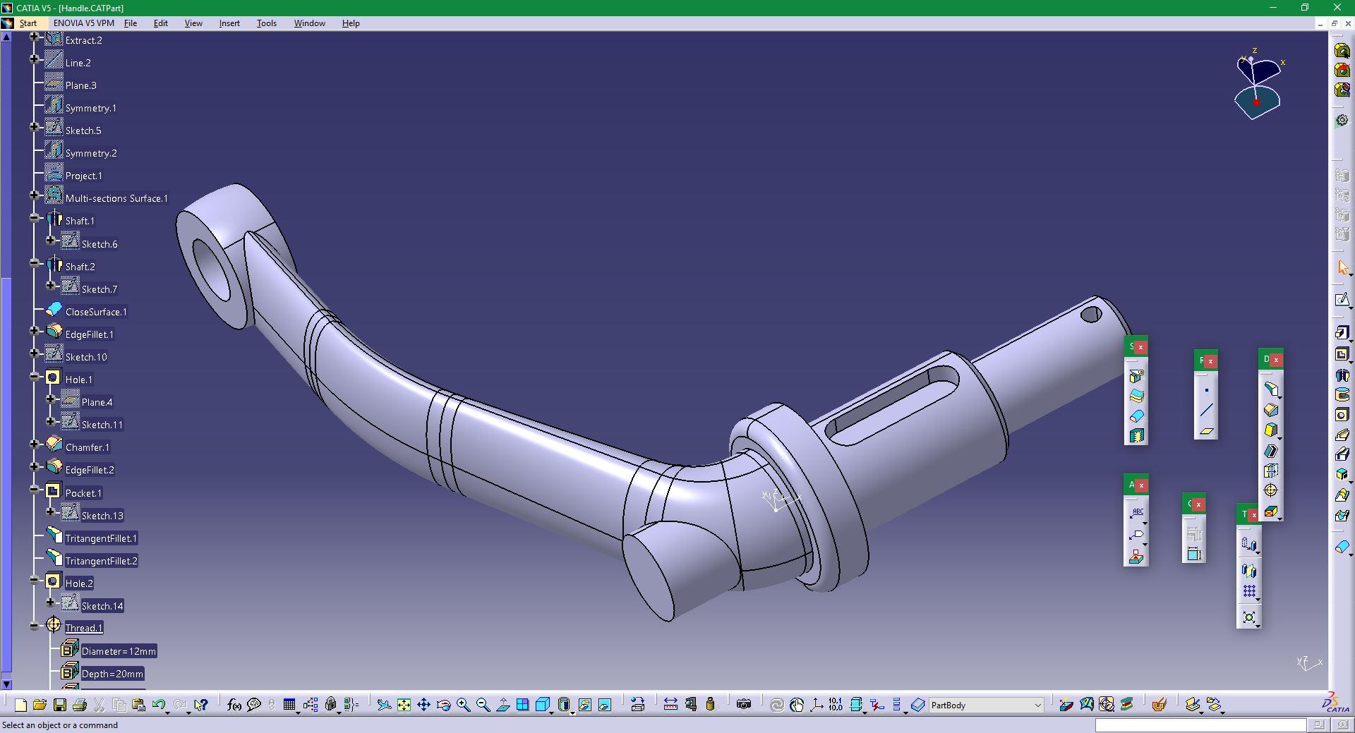

LE: updated the model to correct dimensions
LE2: updated again the model with a new true spine resulting in what i hope to be a better model without assymetry.
I DO find the patch count in the print/picture interesting. Can't quite wrap my head around it..
Anyhow, the model builds very similarly in NX, with the swept form being controlled by 2 guides... the 'taper' from 20 mm to 16 mm is driven with lateral scaling. Didn't bother with the hole or keyway.

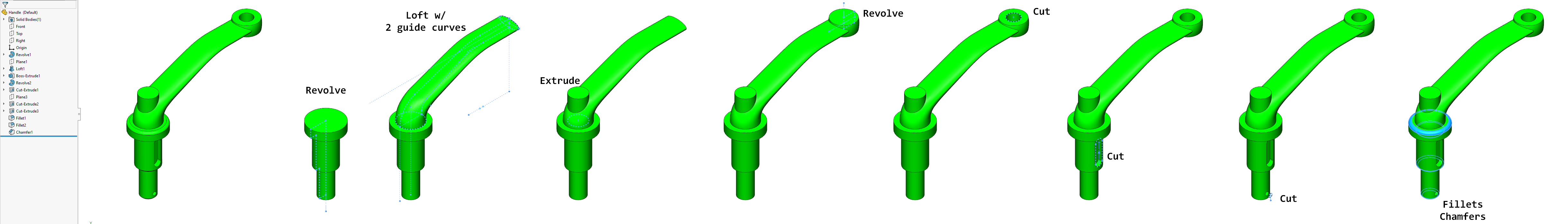

Here is what I made in Solidworks (see attached images)
Here's what I made (see attached images).
The drawing brings up some several questions though. Some dimensions don't make sense. Other dimensions are missing.
This is created in SOLIDWORKS. I assume the workflow will be similar in CREO

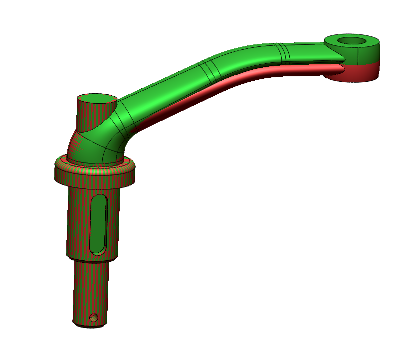

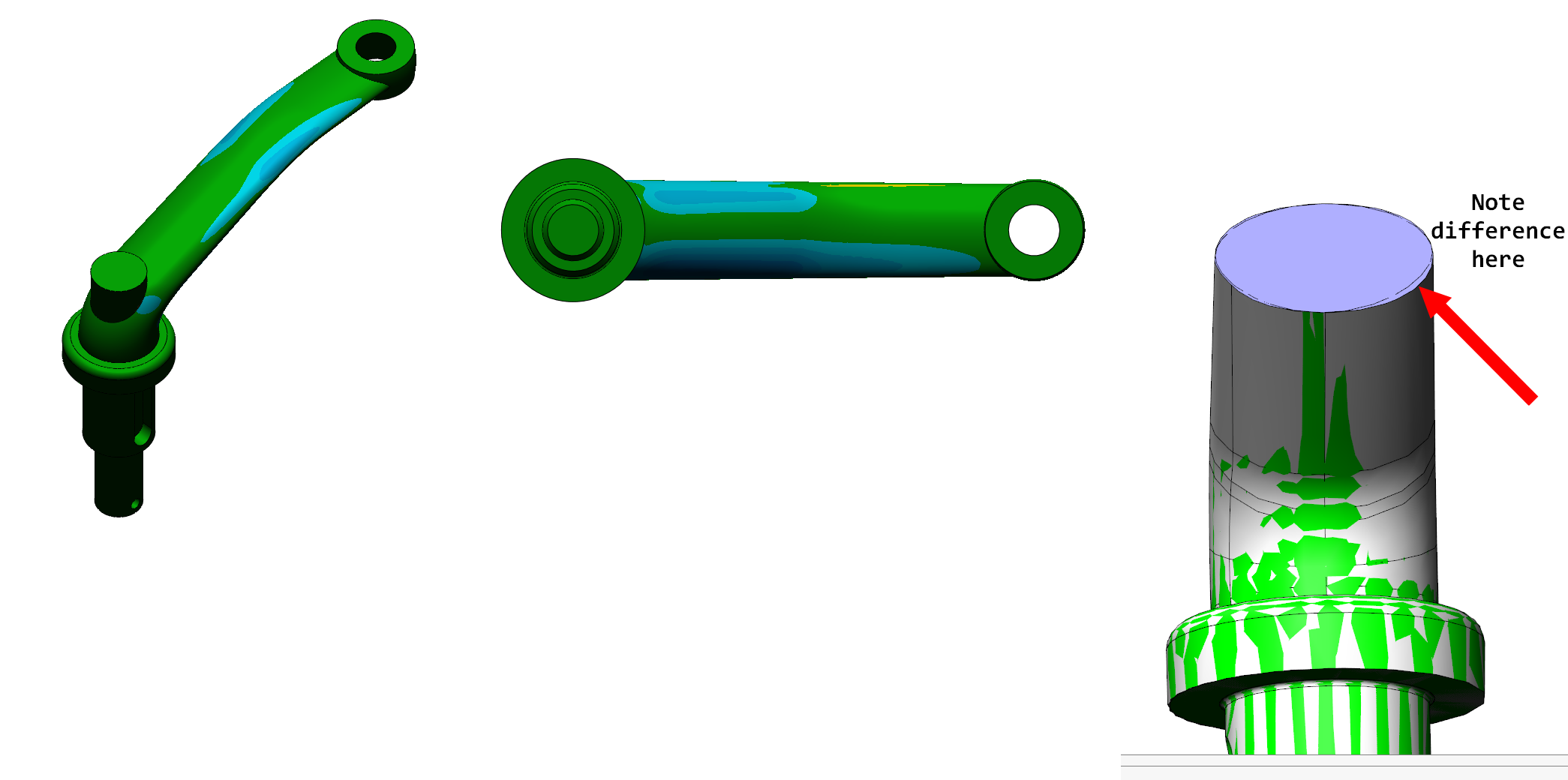

The Error image shows a difference between my model (red) and the one ASI created (green). But that's why parametric models are great. Change one dimension, and the models should match up.
