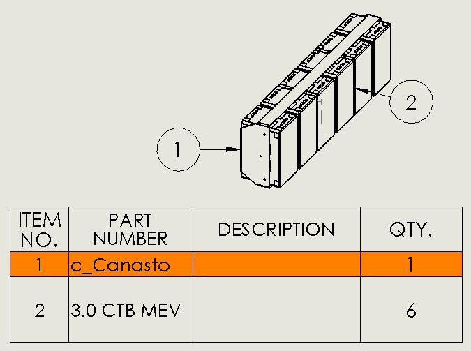

I recently tried to make color in the bill of material table.
I mean, change my row's background to blue, but I think it's impossible.
what do you think?
Accepted answer
There is probably some template or systematic method to achieve this, but I don't know of it.
In any case, if it were really important to do so (even if it is with an impractical method) you can resort to drawing rectangles on a certain color layer and filling them with a hatching pattern, as in the following image:
1 Other answer
"I also tried but couldn't find any option. Maybe SOLIDWORKS doesn't provide a direct, built-in option for changing the background color of entire rows in a Bill of Materials (BOM) table."
