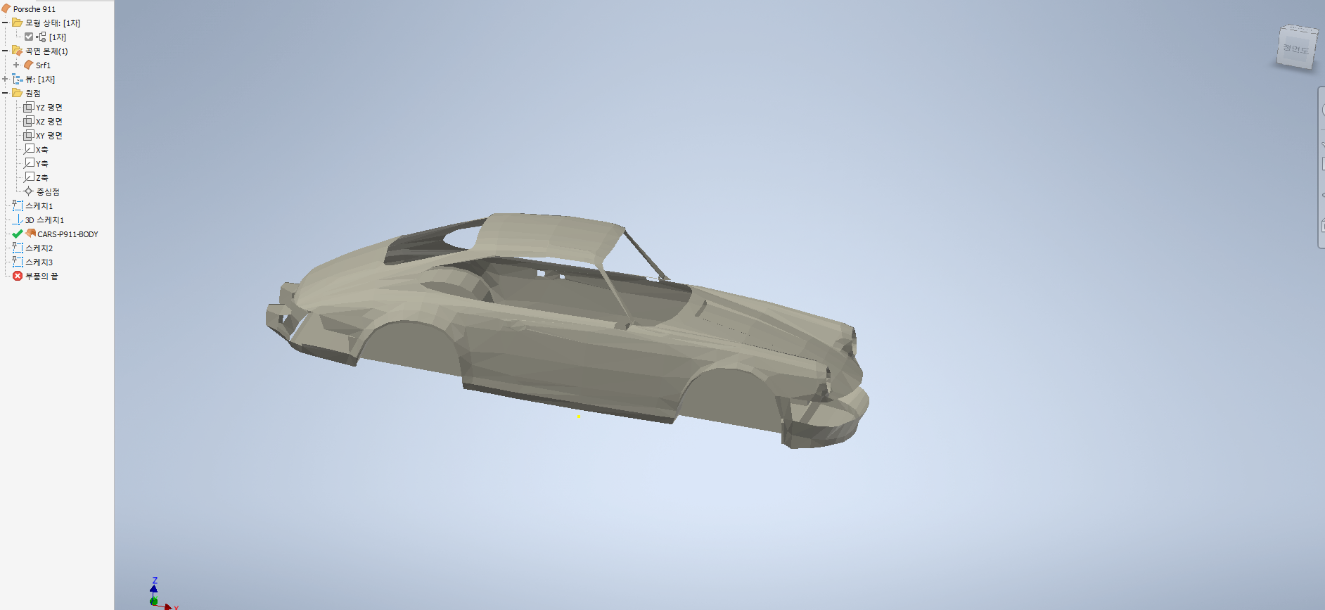

Thankfully, I downloaded the file from the user at the link at the top.
Thanks very much to the creator.
But...I would like to adjust the dimensions(or size) to fit the my Arduino car which working on at university.
Due to my poor inventor skills, I don't know how to adjust the size.
(ex Height adjustment, distance between wheels, etc.)
If anyone knows, please let me know in the comments.
thanks...
This is a low quality surface model likely from a converted tessellated STL or OBJ file. This will take a lot of work to convert to a solid model for Inventor to work with. Until it is converted to a solid model there is NO method to scale it and change the size in Inventor.
If it were a solid model then the method to scale it involves deriving this part into another part and scaling it in the process. But I reiterate: until it is converted to a solid there is no way to scale it in Inventor.
Also, since this is a low quality surface model it is going to be poor quality no matter what scale you make it. I would think you would want to look for a better car model to start with.
