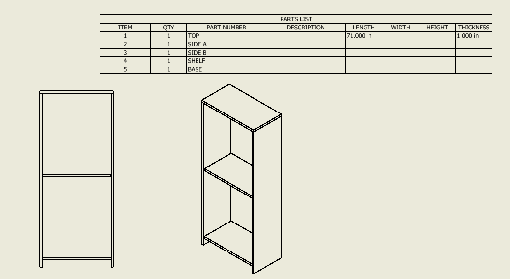

how to make a multibody part in Inventor that can show dimensions on the cutlist
hello everyone!
I have tried a number of methods so that I can achieve my goal by making a Parts List to show the dimensions for each component. I make a multibody part and do "make components" to create an assembly. I also assign parameters for this multibody part. when I create a drawing that shows the Parts List, it can't show the dimensions such as Length, Width and thickness correctly for each component. I know how to add the columns for Length, Width and thickness by using the Styles Editor, but it still doesn't do what I want.

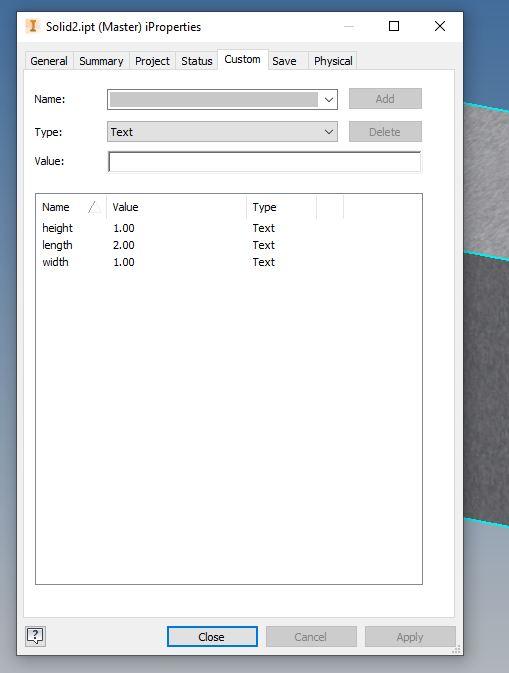

See my attached examples.
1. Multi body part 2.ipt contains three individual bodies yet remains a single part file.
2. The "Make components" command was used to write these bodies out into three individual part files: Solid1.ipt, Solid2.ipt, and Solid3.ipt
3. These 3 IPT files are "Derived" from parent "Multi body part 2.ipt". Any changes made to this parent file will be reflected in the individual IPT files. Changes made to the individual IPT files will have no effect on the parent file.
4. Custom iProperties for length, width, and height were added to the 3 individual IPT files. No iProperties were added to the parent "Multi body part 2.ipt".

6. A drawing (IDW) of "multi body assy.iam" is created.
7. A parts list is added to the drawing and columns for height, width, and length are added.
