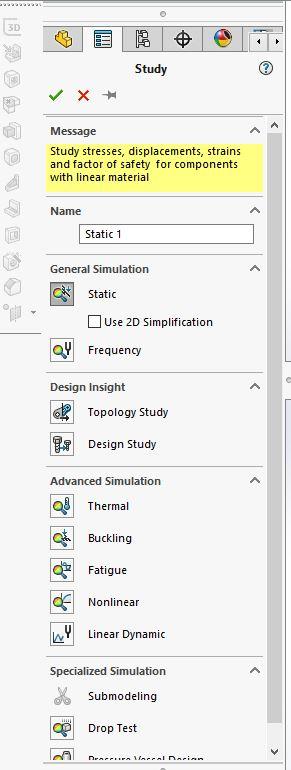

Step 5: Set up Simulation Steps
From the Pull-down menus, select Simulation, Static Analysis, and then select ok (green check).
