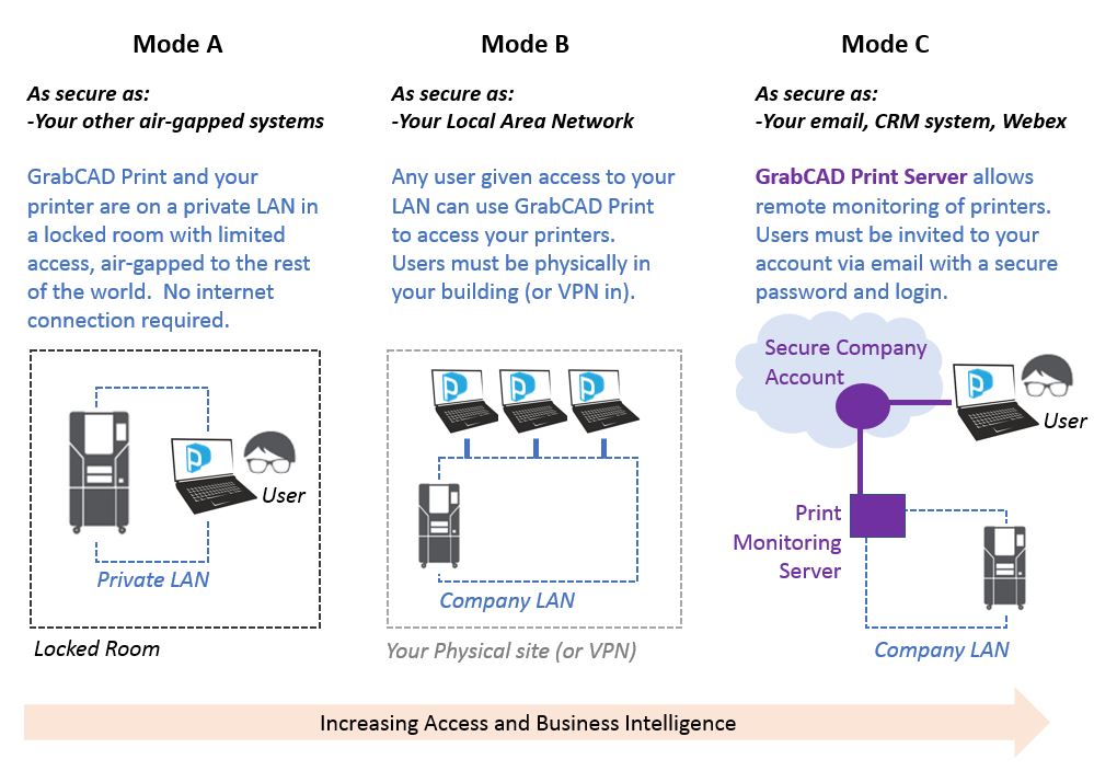

  1. Step 1: The Three Modes of GrabCAD Print
    GrabCAD Print is a 3D printing file preparation software that installs on an engineer's local computer and interfaces with a majority of Stratasys printers.
    There are three ways in which to use it, with three different levels of security:
    For additional information on setting up Mode A, click here.
    For additional information on setting up Mode B, click here.
    For additional information on setting up Mode C, click here.

    While users input CAD data into GrabCAD Print to describe the shapes they want to create, that CAD data never leaves your site. Instead, GrabCAD Print slices CAD data into information only printers can read, which is then sent over your Local Area Network to your 3D printer:
    Even in Mode C from above (remote printing and monitoring), remote users monitoring job history or material usage do not see CAD data sent over the cloud, only meta-data (green) about the prints:
    If Remote Printing is used in conjunction with Mode C (i.e. users who are offsite are also sending jobs to your print queue), then slice data (red line) would travel through your secure company cloud account to your printer, but never CAD data:

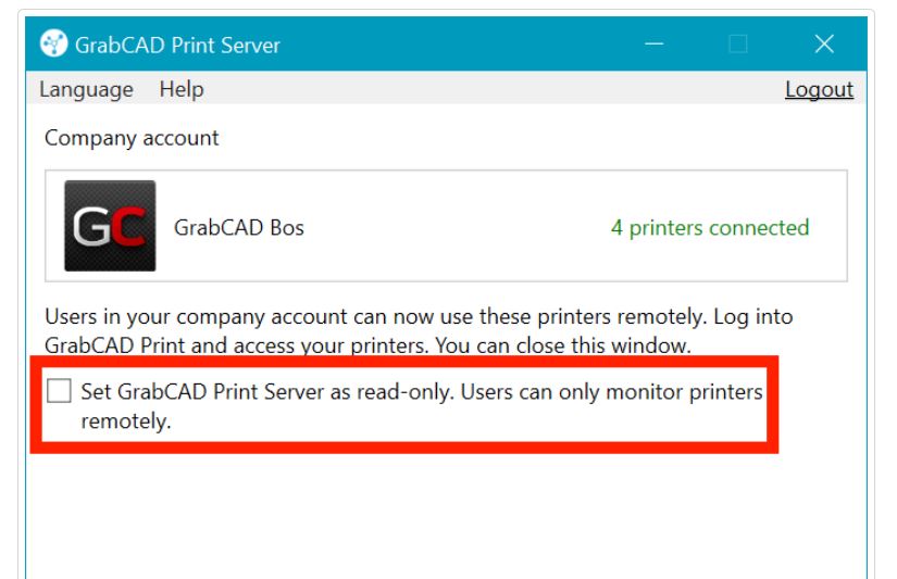

    If you would like to prevent remote printing entirely, during the install of the Print Monitoring Server, you can check a box to make remote users Read-Only (they cannot then add/delete jobs to the queue):
    This prevents even slice data (red line) from being sent over your secure company cloud account in Mode C. Meta-data (green line) would still be accessible (read-only) to authorized users of your company account if you chose Mode C.

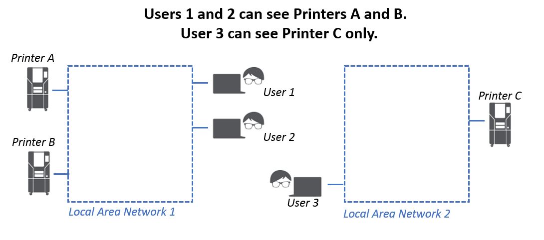

    1. Separate networks for separate printers
    By design, any user of GrabCAD Print can see any supported Stratasys printer on the same Local Area Network (LAN) their computer is currently connected too.
    Therefore, to control access to certain printers some customers put printers on separate LANs only certain users have access to:
    2. Read-only setting on the Print Server
    As previously stated, setting the Print Server to Read-Only (for sites using Mode C) will prevent any remote user from sending, deleting, re-ordering any job in your print queue:
    Besides preventing unauthorized queue access, this is a good way to ensure remote users never accidentally send slice data over an unsecured connection, because they literally will not be able to send jobs from off-site.
    Remote users will still be able to monitor material usage, job progress, printer status through the secure GrabCAD Print app and company webpage, however.
