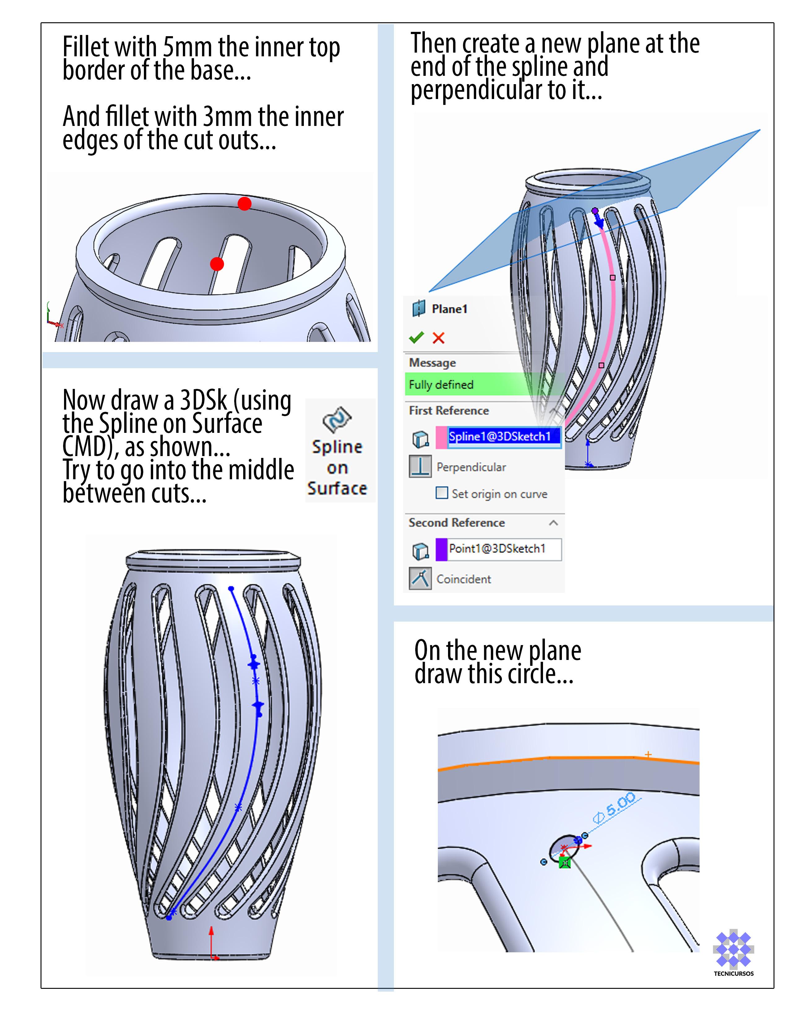

  3. Step 3: Circular Pattern...

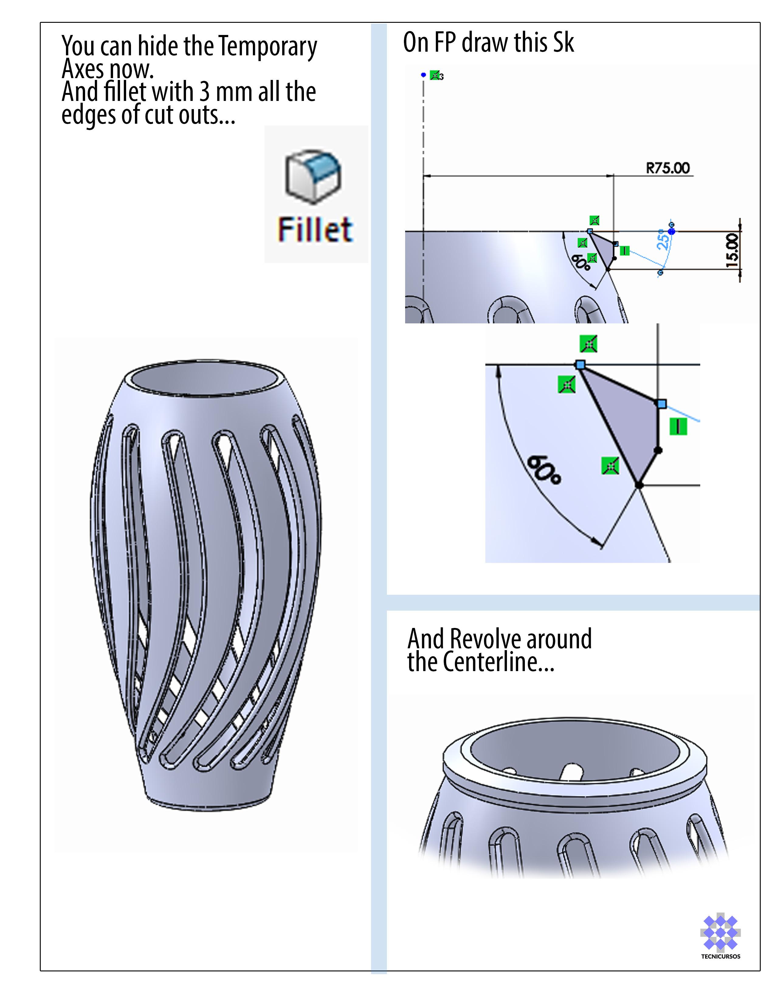

  4. Step 4: Filleting & Creatinf the Top Border...

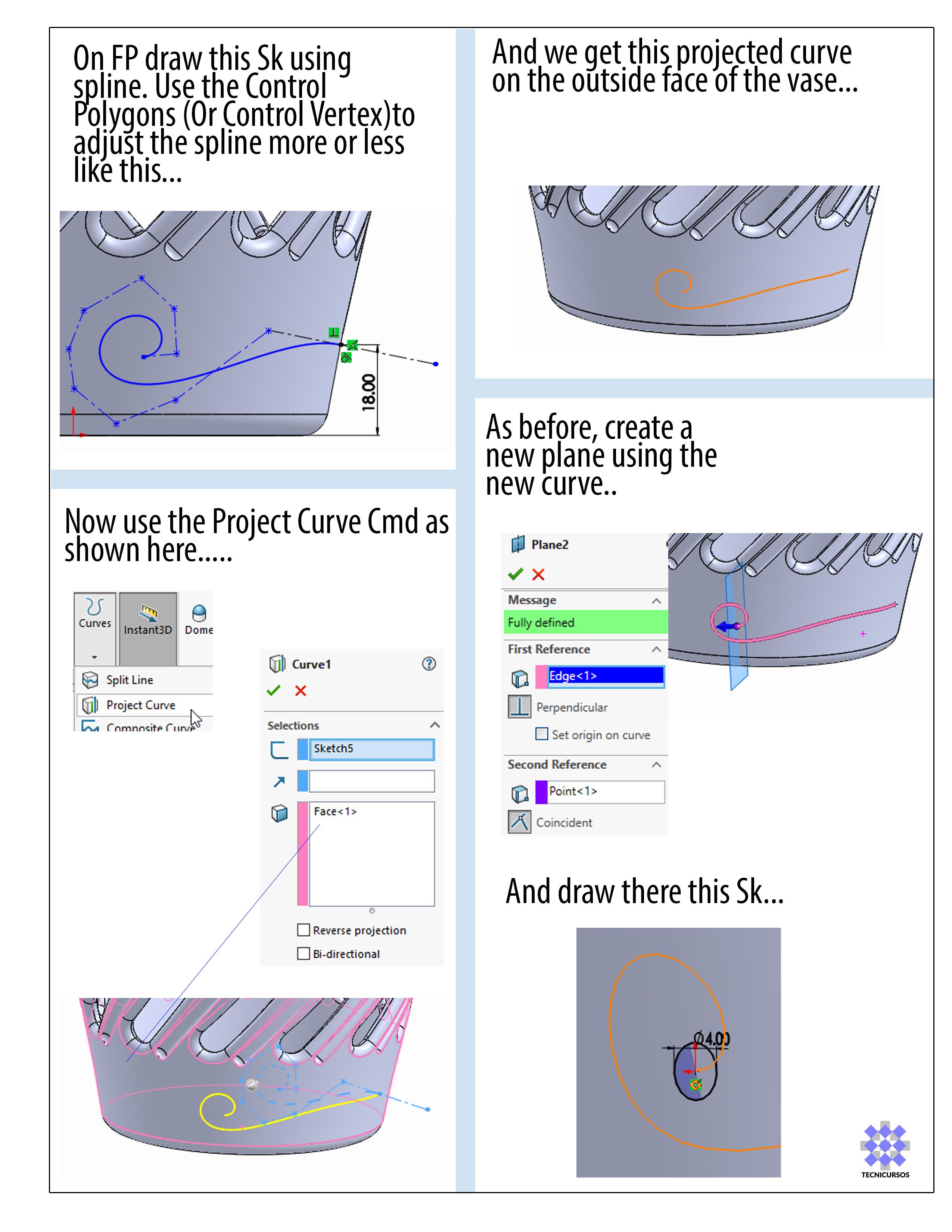

  5. Step 5: Fillets & Surface Grooves...
  6. Step 6: Cutting & Filleting the Groove...

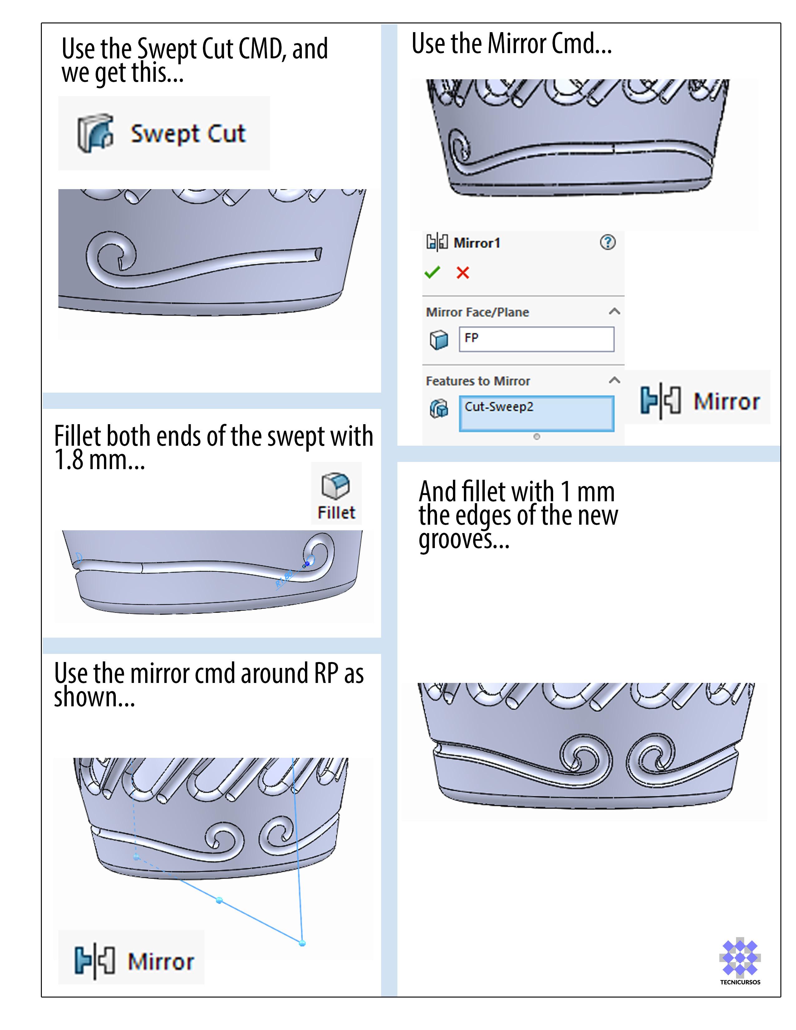

  7. Step 7: DEaling with Base Ornament...
  8. Step 8: Cutting & Mirror...(Fillets)

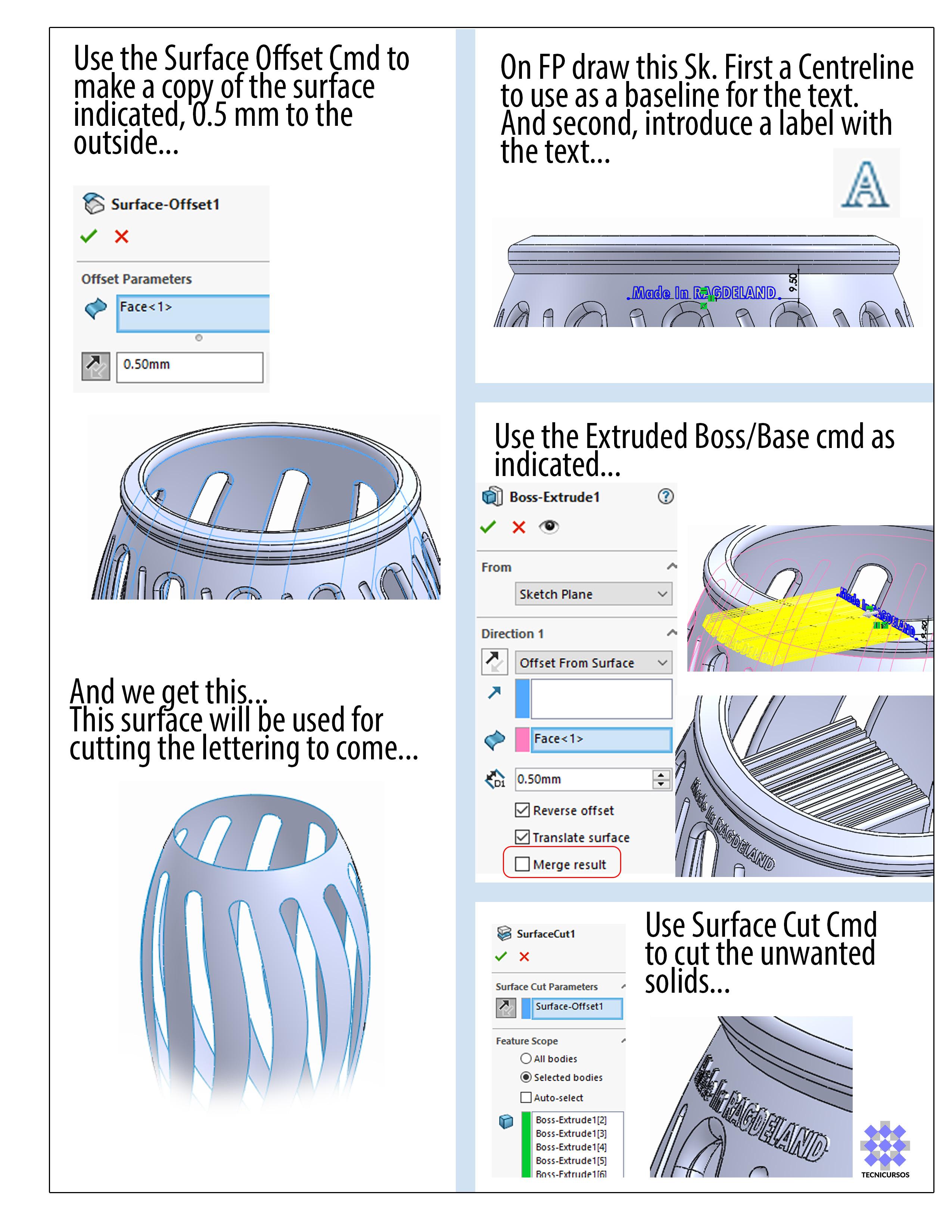

  9. Step 9: Splitting the Vase...
  10. Step 10: Surface Offset & Engraving...
