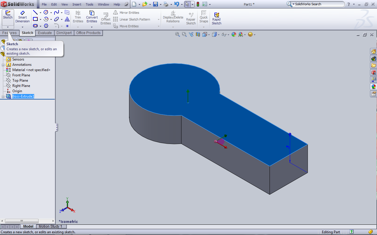

1) select the face on which u want to write the text.

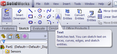

2)click sketch and then click on the text button on the sketch entities tool bar.

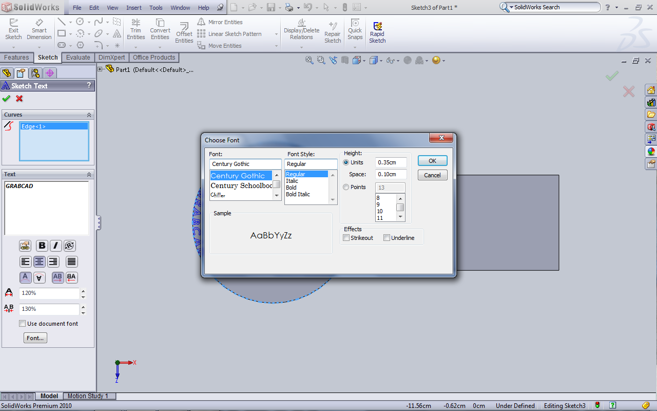

3) select the desired curve and the select the font and other entities for the text.

click sketch and then click on the text button as shown.

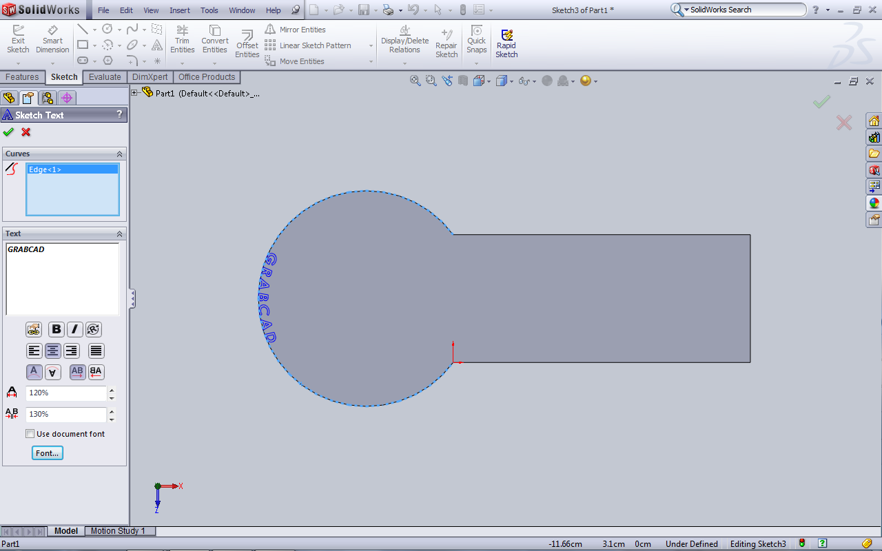

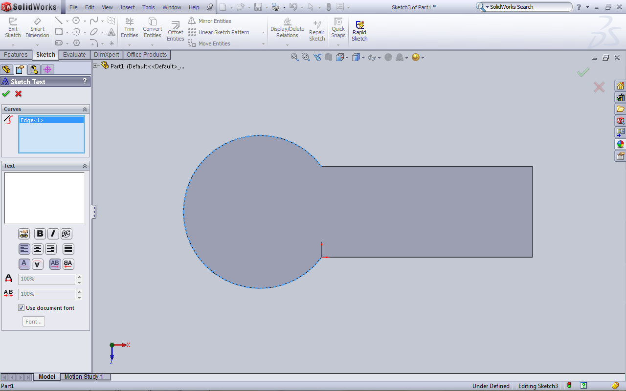

select the desired curve or curves
Step 4:
type the text that u want to write on the curve

select the font and other entities.

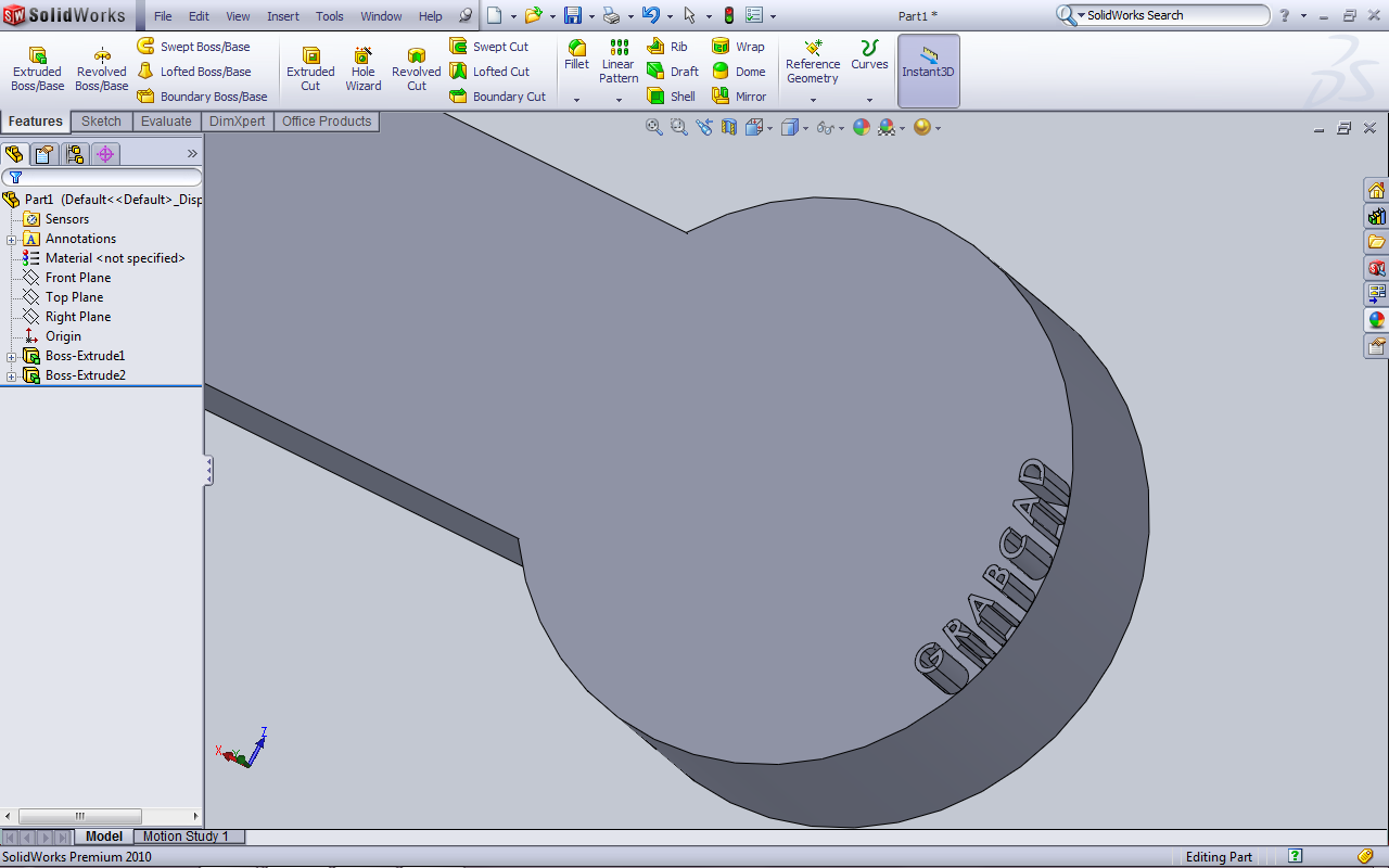

then simply go to features, select the desired feature and click OK.
you get your text.
