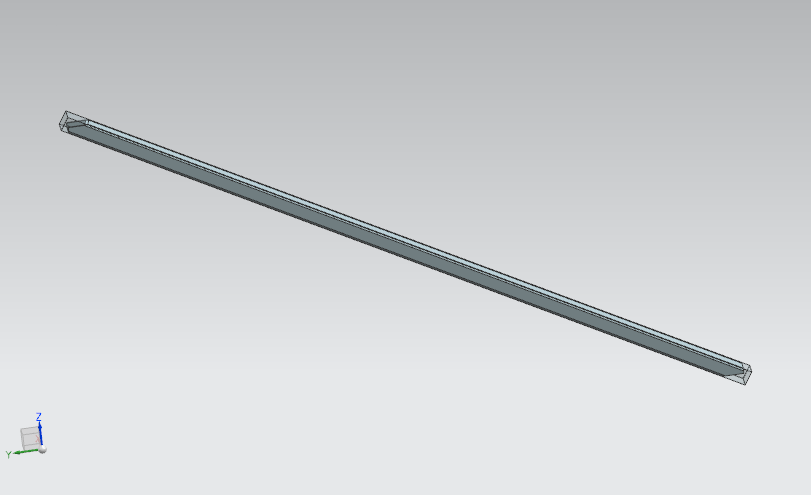

    It would not be some huge problem if beams in assembly had 90° cut on both sides but... as you can see on picture below it have two surface cuts on both ends and these cuts are on some distance from actual extrude used to make base length of beam. So we can not use extrude parameters as length of beam.
  2. Step 2:

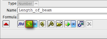

    As we can't use any of existing parameters as length of beam we have to measure it. To get length of beam that is cut we will use expressions and measurement tool. First go to Tools>Expression... or just use Ctrl+E shortcut. Then you have to make new expression named for example "length_of_beam" ...
  3. Step 3:
    ... and use "Measure distance" to add value to expression.

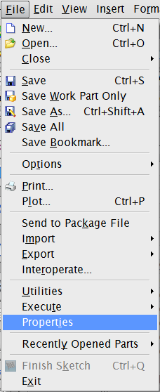

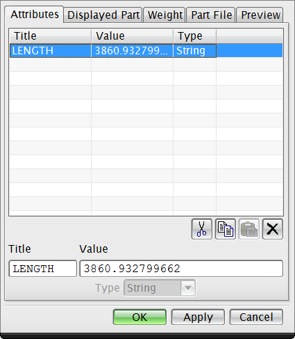

    After this is done, click on OK, and confirm new parameter in expression window.

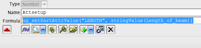

    Now we have to make one more expression that will put this measured value in attributes so we can easily access to it from drawing assembly and use it in tables. Make new expression like this:
  10. Step 10:
    this will give us Part Attribute named "Length" with value that is maximal length of this beam.

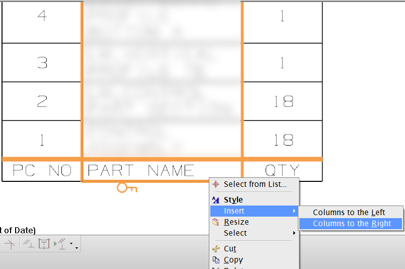

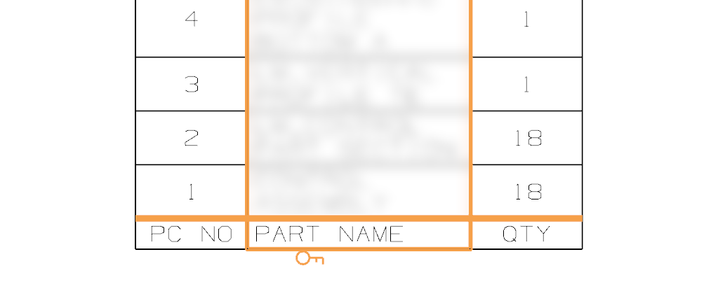

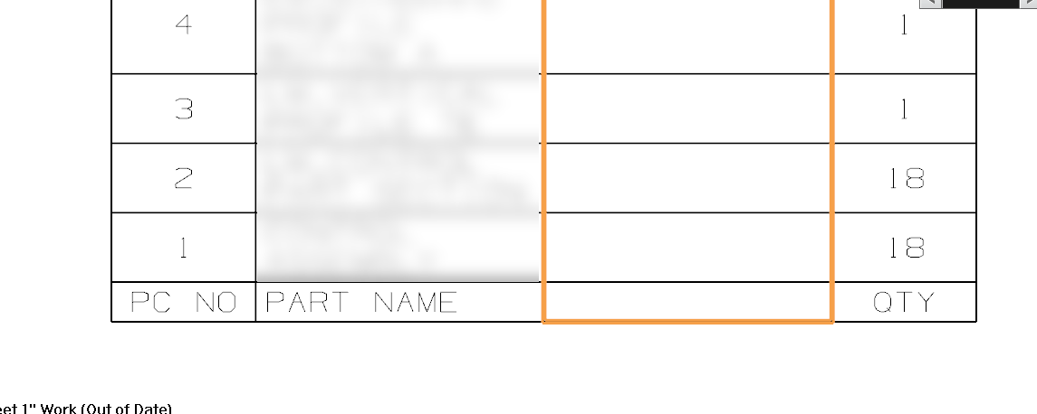

    To use this in drafting table that will give us list of lengths of all beams we have in some assembly (in my case i have 1000+ beams per assembly) we have to go to assembly that we will use for drafting, and to make part list table. In default it will look sometime like this:
  13. Step 13:
    Now select "Part Name" column and from right click menu use Insert>Columns to the right
  14. Step 14:
    Select new column
  15. Step 15:
    And from right click menu select "Style"

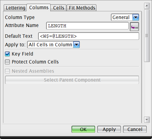

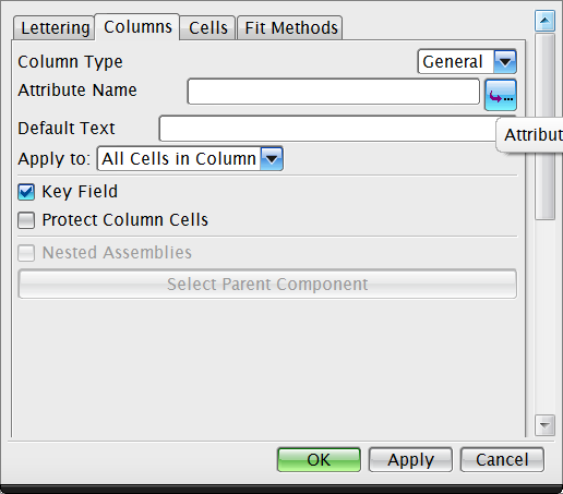

    In style window go to "Column" tab:
  17. Step 17:

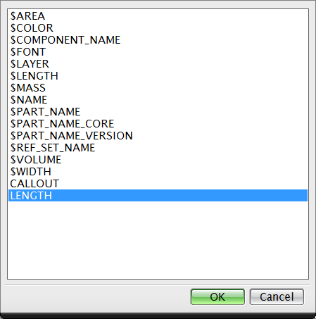

    for "Attribute Name" field click on "Attribute names" button and select "Length" from list:
  18. Step 18:
    OK this and you will have:
