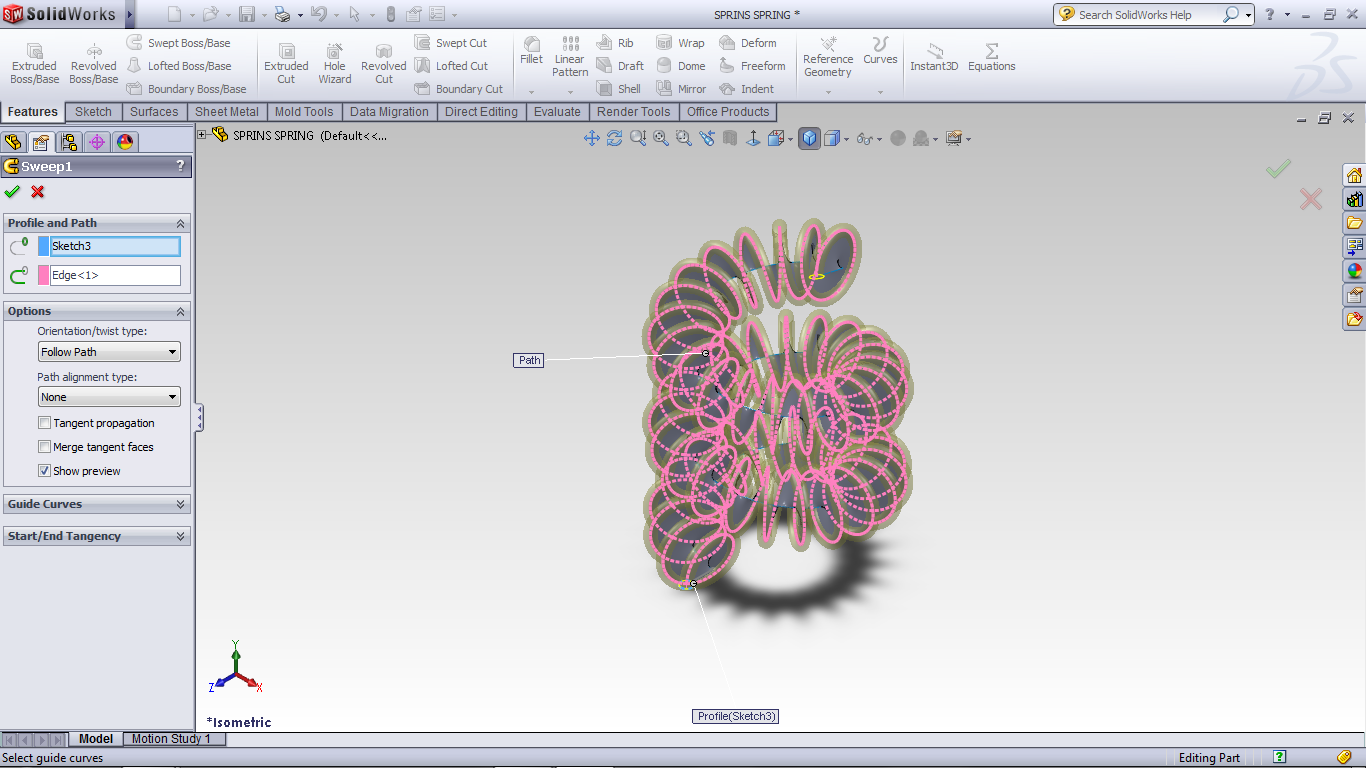

Now draw a line at right plane and coincident to the helix start point.
Step 4:
now use surface sweep commend to make a sweep of line which is twist along path. you can refer all parameters from fig.

Step 7:
Now sweep that circle along path the edge of that surface sweep line.
